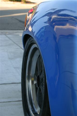

I kinda like the SC flair also. This one looks like Mike D's car. (IMG:http://www.914world.com/bbs2/html/emoticons/biggrin.gif)

Joe Sharp   I kinda like the SC flair also. This one looks lik...   Mar 13 2005, 08:13 AM
Joe Sharp   225 50 16 with a 19mm spacer. Joe   Mar 13 2005, 08:19 AM
