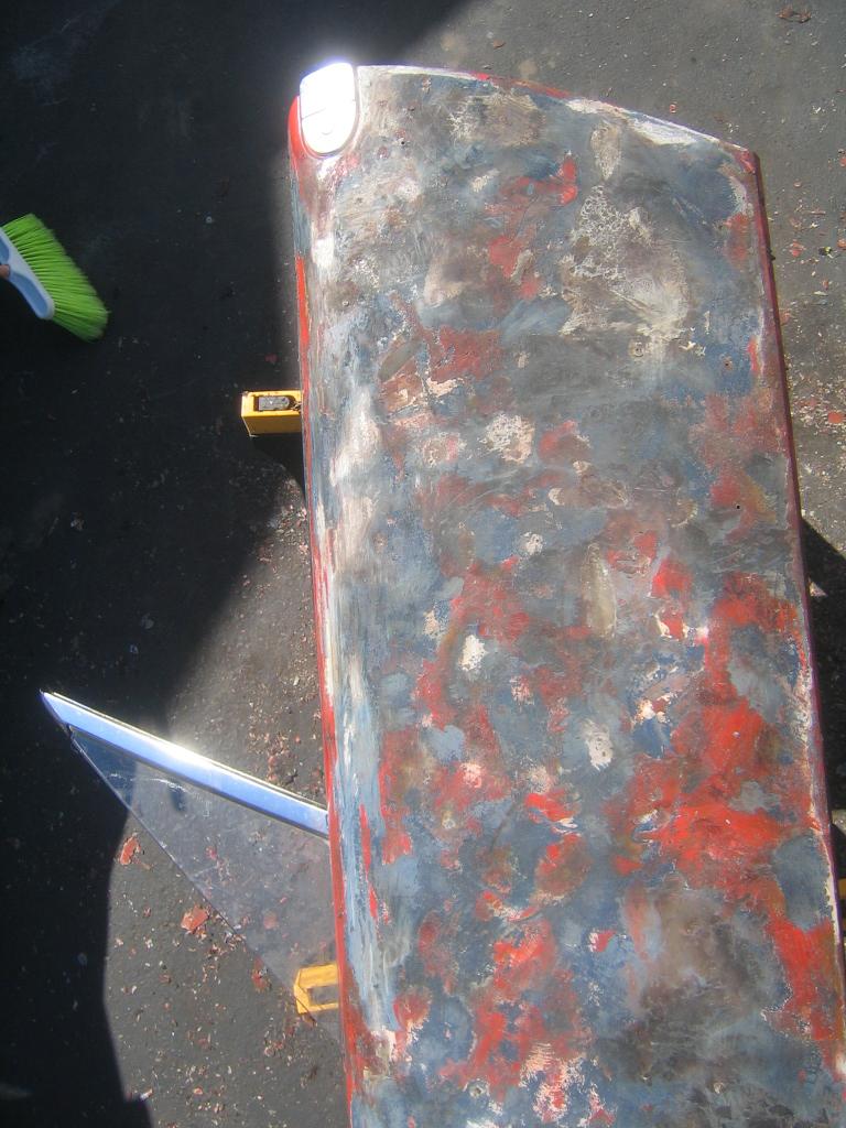

and i ended up stripping the whole thing, filler, paint and all, and i took off the doorpanel to find some treasures inside
to strip, first i used a torch and scraper, then i applied chemical stripper, scraped it, and then a second coat and scraped that, and it came pretty clean...and wow did i uncover alot of dents!!!
this is after the torch and scraper

i love porsche   thank god for spring break, first time ive been ab...   Mar 15 2005, 10:00 PM
i love porsche   after teh first coat of stripper   Mar 15 2005, 10:00 PM
i love porsche   after the second coat   Mar 15 2005, 10:01 PM
