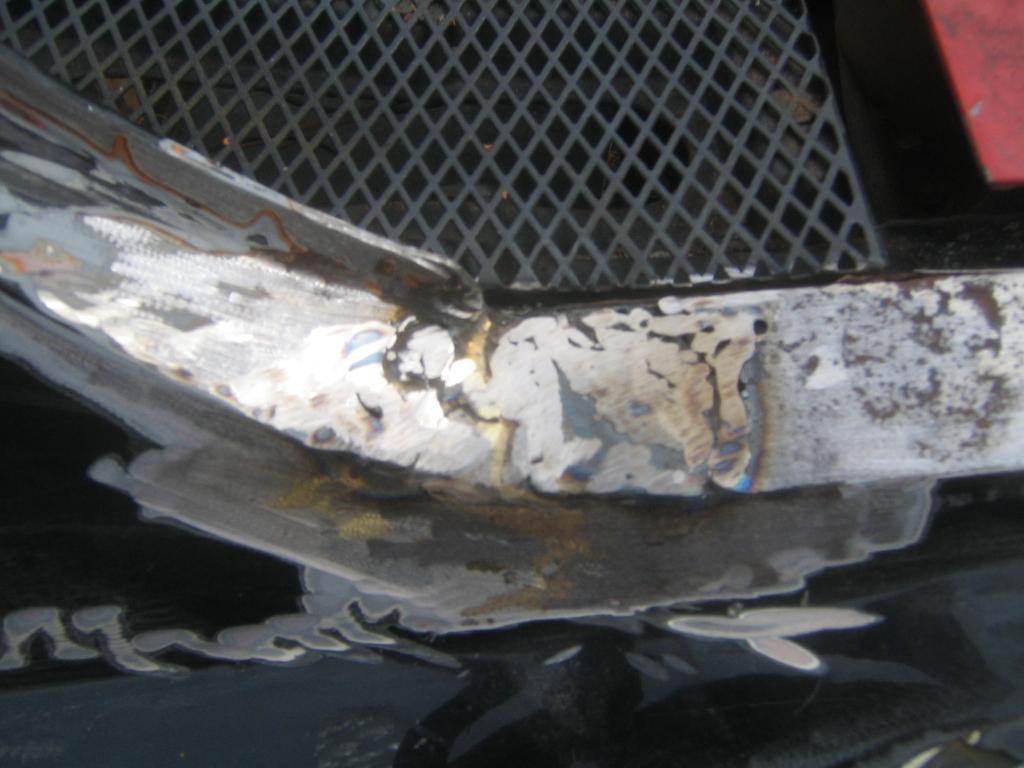

i love porsche   ok..so i began repair on a rust hole in the front ...   Aug 20 2004, 09:55 PM
i love porsche   the donor piece   Aug 20 2004, 09:55 PM
i love porsche   all fitted up   Aug 20 2004, 09:56 PM
i love porsche   all welded up :welder: not too bad for a first ...   Aug 20 2004, 09:57 PM
