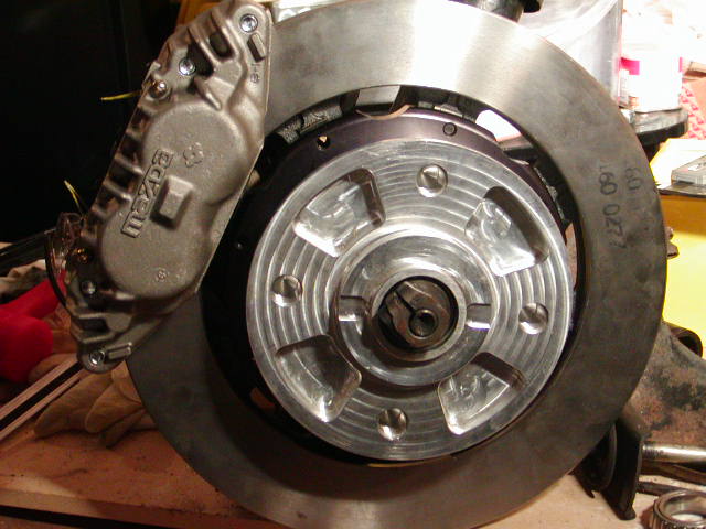

> Yippee...problem solved...I've got big brakes :), up front at least for now :)

The pad overhang was not as bad as I had originally thought.....taking the pads to the bench grinder (recommended by a high performance brake pad engineer), I just need to add a chamfer to the edge of the pad to get rid of the overhang......pretty darn easy once I gave it a shot....
the adapter itself will be pretty easy to make and shouldn't cost me much at all for supplies....
I know have to decide what color to paint the calipers (IMG:http://www.914world.com/bbs2/html/emoticons/smile.gif)

this ought to look nice behind my Revolution rims once painted and detailed a little better

Twystd1   Mike... You are simply amazing........ Sometimes ...   Mar 20 2005, 02:25 AM
URY914   Please take a grinder and get rid of the "MAZDA". ...   Mar 20 2005, 06:15 AM
Qarl   It looks pretty nice... except for the MAZDA crap....   Mar 20 2005, 07:23 AM
michel richard   Did I miss an earlier thread ? Have you given det...   Mar 20 2005, 07:58 AM
McMark   Now that's taking stock to a new level. http:...   Mar 20 2005, 09:53 AM

scott thacher   so 500 including pads... ouch   Mar 20 2005, 09:58 AM
scotty b   http://www.914world.com/bbs2/...   Mar 20 2005, 10:00 AM
914efi   I milled the 'mazda' off mine. I wish I di...   Mar 20 2005, 10:09 AM

fiid   Wow mike. That's awesome. Good job!   Mar 20 2005, 12:08 PM

Andyrew   Ya... I saw the wood, lol Lookin good! I ne...   Mar 20 2005, 03:51 PM
