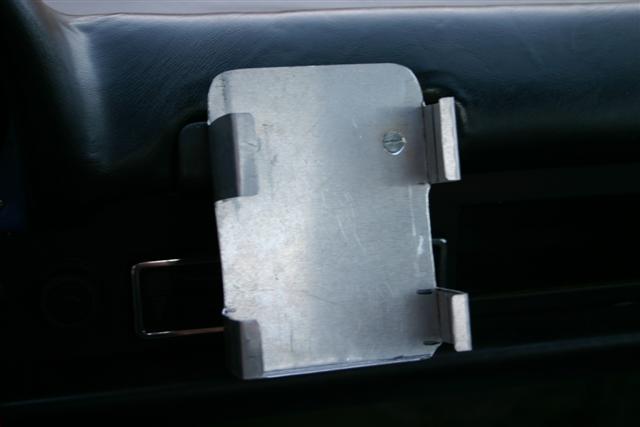

The Bracket.
(IMG:http://www.914world.com/bbs2/html/emoticons/biggrin.gif) Joe

Joe Sharp   Oh yeah! Imade a bracket for the LM-1n and put...   Mar 21 2005, 08:40 AM
Joe Sharp   The LM-1 on the dash. http://www.9...   Mar 21 2005, 08:41 AM
Joe Sharp   The Bracket. http://www.914world.c...   Mar 21 2005, 08:43 AM
