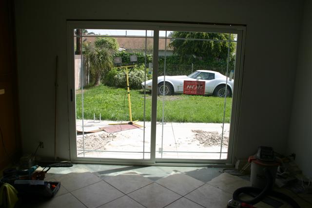

I forgot that I had a window put in yesterday. Now I can finish the Rock.
(IMG:http://www.914world.com/bbs2/html/emoticons/biggrin.gif) Joe
