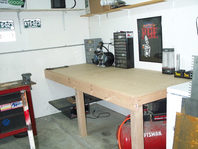

Performed some much-needed garage improvement.
I built a new work bench that's big enough to spread out a little and added some shelves and a TV (shhhhh, my wife doesn't know).
