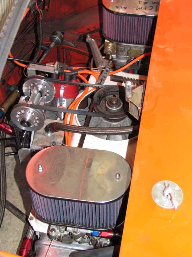

The Tangerine crew pulled in to the shop at around 1Am this morning....
Chris has come down to install his new F Production RAT engine with HAm heads that are VERY insane! We are finishing up the engine today and it should be on the dyno tonight and tested tomorrow. We plan on doing some extensive testing with this engine to scrounge every bit of power it possibly has out of it. I plan on doing some carb and velocity stack swaps, venturi swaps and we are even going to do some DTM testing with it Vs Chris' modified corvair fan arrangement both for power as well as running temp comparisons.
This is actually the least developed engine that we will be building Chris as it is the "Regular Season engine". It is still a very nasty animal that will make gobs of power, but since it's a regular season engine it also has to be much more longevity filled and therfore not as many risks can be taken with its tolerances.
The "Runoffs engine" is a different story. It only has to live for two hours for one weekend of racing so it will have every trick known to man and even crazier HAM heads.
With Chris' excellent driving skills and a pair of RAT engines with Len doing things to the heads that have never been done before to this level it is our goal to get a 914 on the podium at the runoffs and thats something that hasn't happened in about 20 years!

2. RAT motor with Chris's corvair based cooling- it sounded awsome.

SGB   1. Crew before 1st saturday practice   Mar 26 2005, 05:44 PM
SGB   3. SHEE-II-___ back in two laps- whats wrong?   Mar 26 2005, 05:49 PM
Jake Raby   The lack of sleep did play into todays events.. T...   Mar 26 2005, 05:56 PM
SGB   Len holds the evil spark plug... see that channel ...   Mar 26 2005, 05:59 PM
Jake Raby   Yep... That was the first sign of an issue.. That...   Mar 26 2005, 06:08 PM

Jake Raby   Chris had just looked at the EGT right before it h...   Mar 26 2005, 07:12 PM

Racer Chris   First of all let me say that there was nothing wro...   Mar 26 2005, 09:56 PM
