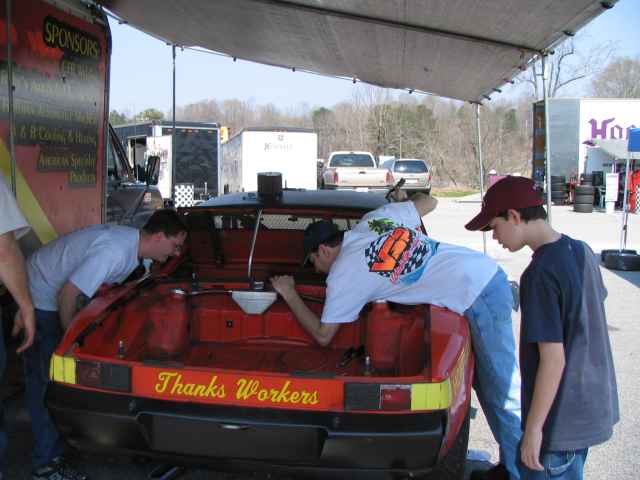

SGB   1. Crew before 1st saturday practice   Mar 26 2005, 05:44 PM
SGB   2. RAT motor with Chris's corvair based coolin...   Mar 26 2005, 05:46 PM
Jake Raby   The lack of sleep did play into todays events.. T...   Mar 26 2005, 05:56 PM
SGB   Len holds the evil spark plug... see that channel ...   Mar 26 2005, 05:59 PM
Jake Raby   Yep... That was the first sign of an issue.. That...   Mar 26 2005, 06:08 PM

Jake Raby   Chris had just looked at the EGT right before it h...   Mar 26 2005, 07:12 PM
Joe Ricard   Well for what it is worth a problem was going to h...   Mar 26 2005, 08:08 PM
Racer Chris   First of all let me say that there was nothing wro...   Mar 26 2005, 09:56 PM
