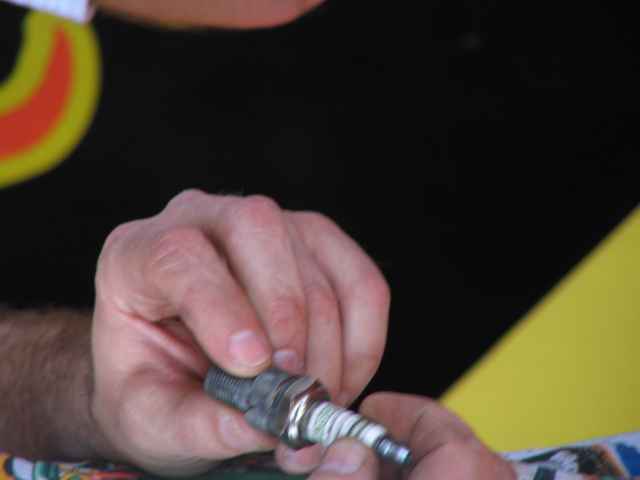

Len holds the evil spark plug...
see that channel that has been scoured out by the exhaust? The head didn't like it either.
Jake theorized that sumthing was unhappy in the carb barrel for that cylinder- lean= hot= hole.
They called it a learning experience.
