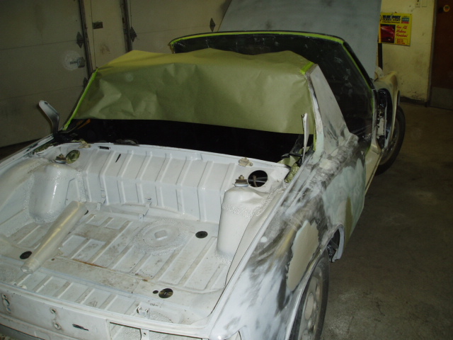

xsboost90   time to get her all stripped for some primer/ pain...   Feb 26 2005, 07:41 PM
xsboost90   got the quarter stipped and sanded completely, sti...   Feb 26 2005, 07:43 PM
xsboost90   drivers quarter is perfect but the ps has some dam...   Feb 26 2005, 07:46 PM
xsboost90   heres the doors while stripping them. ONce again t...   Feb 26 2005, 08:23 PM

xsboost90   in most cases, when im painting a car, ill just sa...   Feb 26 2005, 09:25 PM

xsboost90   sprayed alittle primer tonite, its just for blocki...   Mar 4 2005, 09:54 PM
xsboost90   more primer.   Mar 4 2005, 09:56 PM
Steve Thacker   Keep it up Dan,...just keep focusing on the end pr...   Mar 5 2005, 07:54 AM
CptTripps   What did you use for primer? Just rattle-can stuff...   Mar 6 2005, 09:23 PM
