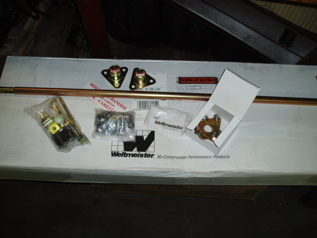

nice weltmeister sway bar showed up today at work, nice!
