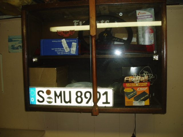

my cabinet o' goodies

xsboost90   nice weltmeister sway bar showed up today at work,...   Mar 31 2005, 09:50 PM
xsboost90   my cabinet o' goodies   Mar 31 2005, 09:50 PM
CptTripps   Sweet... I HOPE I'm in primer by the weekend....   Mar 31 2005, 09:55 PM
xsboost90   mine would be mostly in primer by now but this qua...   Mar 31 2005, 09:58 PM
