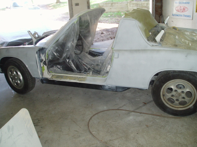

naw, i think i got the quarter whipped, got most of the car in primer today, front fenders, rear quarters, both trunk lids, ds door. Still need to finish the ps door and the engine cover, do some small ding repair on the fenders, etc but almost there.
