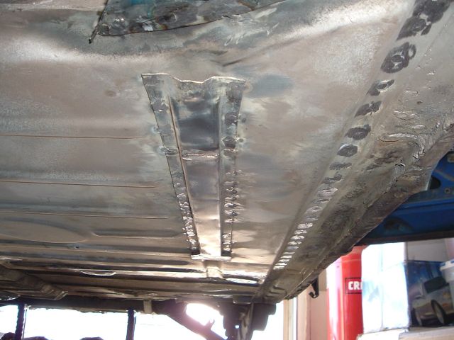

Now back on topic...Passenger side floor re-enforcement (grafted together from 2 partially rusted ones).

cdmcse   Well, after the arrival of our new son (March 6th)...   Apr 4 2005, 10:52 PM
cdmcse   Driver's side floor re-enforcement, this one i...   Apr 4 2005, 10:56 PM
cdmcse   Right Rear Floor Jackpoint.   Apr 4 2005, 10:56 PM
cdmcse   Left Rear Jackpoint.   Apr 4 2005, 10:57 PM
cdmcse   Engine Shelf installed. I finally got all the part...   Apr 4 2005, 10:58 PM
cdmcse   The interior all grinded and stripped ready to POR...   Apr 4 2005, 10:59 PM
