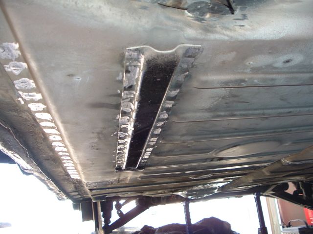

Driver's side floor re-enforcement, this one is new.
