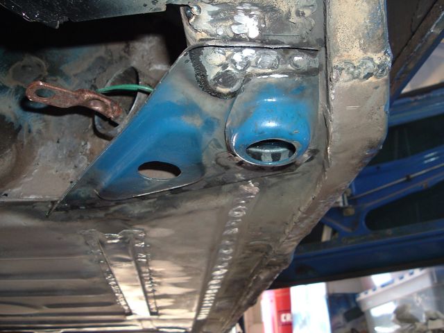

Right Rear Floor Jackpoint.

Lou W   Looks great, keep the pictures coming. I'm get...   Feb 13 2005, 01:30 AM
Bleyseng   Whats with the electrical cable coming out of the ...   Feb 13 2005, 09:41 AM
jd74914   looks good http://www.914worl...   Feb 13 2005, 10:10 AM
cdmcse   These cables in the heater tubes are for a front t...   Feb 13 2005, 11:25 AM
