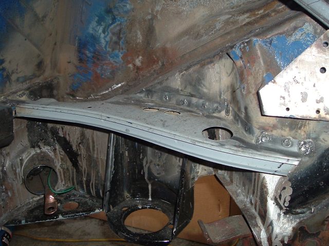

It seemed like it was going to take forever to make some progress on my rust repair. After spending the entire winter locating parts, grinding, cuting, painting, and learning to weld, I was finally ready to take the plunge....
Also thanks to everyone on the board, I would have never had enough confidence to tackle this without this site!!!

Engine Shelf installed. I finally got all the parts I need from Restoration Design.

cdmcse   The repair piece from a parts car.   Feb 13 2005, 12:18 AM
cdmcse   Clamped.   Feb 13 2005, 12:19 AM
cdmcse   Welded (no making fun) http://www....   Feb 13 2005, 12:20 AM

Lou W   Looks great, keep the pictures coming. I'm get...   Feb 13 2005, 01:30 AM
Bleyseng   Whats with the electrical cable coming out of the ...   Feb 13 2005, 09:41 AM
jd74914   looks good http://www.914worl...   Feb 13 2005, 10:10 AM
cdmcse   These cables in the heater tubes are for a front t...   Feb 13 2005, 11:25 AM
