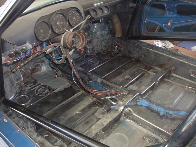

cdmcse   Well, after the arrival of our new son (March 6th)...   Apr 4 2005, 10:52 PM
cdmcse   Now back on topic...Passenger side floor re-enforc...   Apr 4 2005, 10:54 PM
cdmcse   Driver's side floor re-enforcement, this one i...   Apr 4 2005, 10:56 PM
cdmcse   Right Rear Floor Jackpoint.   Apr 4 2005, 10:56 PM
cdmcse   Left Rear Jackpoint.   Apr 4 2005, 10:57 PM
cdmcse   Engine Shelf installed. I finally got all the part...   Apr 4 2005, 10:58 PM
cdmcse   The Firewall had Zero Rust!!!! Yay...   Apr 4 2005, 11:01 PM

cdmcse   A little farther along... POR-15 Silver Applied   Apr 7 2005, 11:08 PM
cdmcse   Another...   Apr 7 2005, 11:10 PM
Root_Werks   Sweet! Another 914 saved from the rust monste...   Apr 8 2005, 08:44 AM
maf914   Way to go, Chris! Great looking work. Also...   Apr 8 2005, 11:17 AM
cdmcse   Well I reached what I feel like is a major milesto...   Apr 12 2005, 09:44 PM
cdmcse   Another...   Apr 12 2005, 09:45 PM
cdmcse   Another   Apr 12 2005, 09:46 PM
cdmcse   Last one. Now just a few more bits on the outside ...   Apr 12 2005, 09:47 PM
