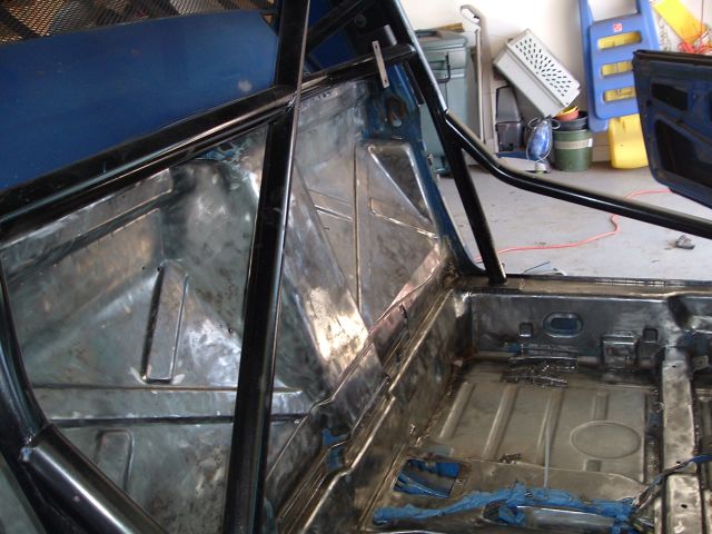

cdmcse   The interior all grinded and stripped ready to POR...   Apr 4 2005, 10:59 PM
cdmcse   The Firewall had Zero Rust!!!! Yay...   Apr 4 2005, 11:01 PM
