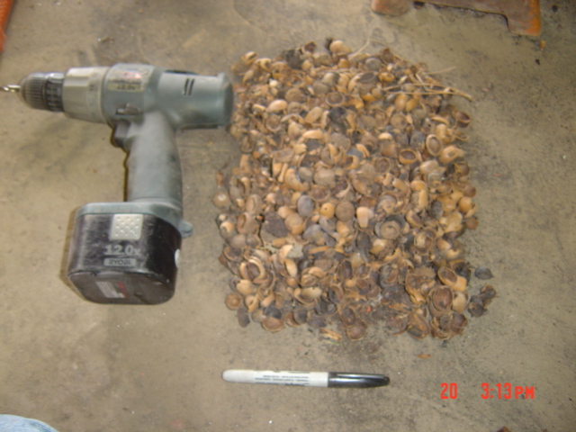

MORE DAMN NUTZ from inside the long. the pile is as deep as the drill is thick! No the marker was not in there

scotty b   MORE DAMN NUTZ from inside the long. the pile is a...   Apr 6 2005, 06:33 PM
