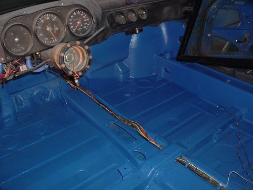

Well I reached what I feel like is a major milestone...got the interior done except for re-assembly. After watching CptTripps bedliner his interior with good results, deceided I would like some texture inside as well.
Here is what I did to my interior...
1) took it down to bare metal (mostly)
2) Clean, Metal-ready, POR-15 Silver
3) Etching Primer
4) Paintable textured undercoating
5) Sealing Primer
6) Adriatic Blue Topcoat
I think it turned out real well. Since I'm not putting carpet in there I think it will be pretty durable too.
