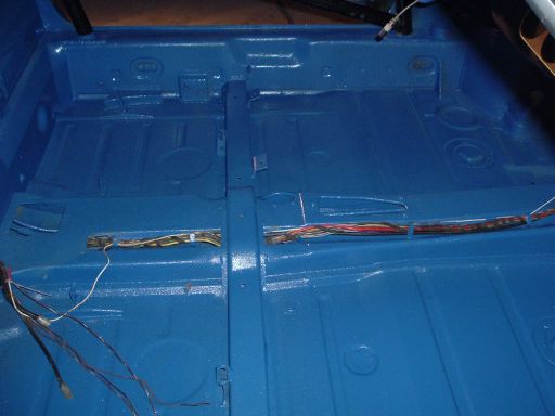

cdmcse   OK, more progress...Top coated the POR-15 with som...   Mar 4 2005, 01:22 AM
cdmcse   http://www.914world.com/bbs2/...   Mar 4 2005, 01:23 AM
cdmcse   Driver's Side.   Mar 4 2005, 01:24 AM
cdmcse   Passenger Side. Next I have to finish the passenge...   Mar 4 2005, 01:26 AM

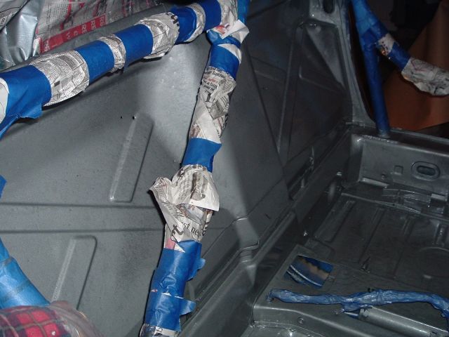

cdmcse   A little farther along... POR-15 Silver Applied   Apr 7 2005, 11:08 PM
cdmcse   Another...   Apr 7 2005, 11:10 PM

cdmcse   Well I reached what I feel like is a major milesto...   Apr 12 2005, 09:44 PM
cdmcse   Another...   Apr 12 2005, 09:45 PM
cdmcse   Another   Apr 12 2005, 09:46 PM
cdmcse   Last one. Now just a few more bits on the outside ...   Apr 12 2005, 09:47 PM
dakotaewing   How did you apply the Por-15 and primer? Gun or br...   Apr 12 2005, 09:52 PM
