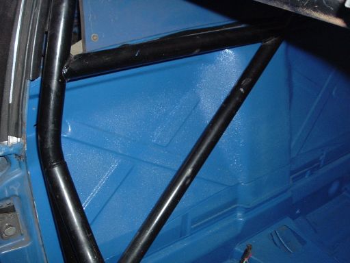

cdmcse   A little farther along... POR-15 Silver Applied   Apr 7 2005, 11:08 PM
cdmcse   Another...   Apr 7 2005, 11:10 PM

cdmcse   Well I reached what I feel like is a major milesto...   Apr 12 2005, 09:44 PM
cdmcse   Another...   Apr 12 2005, 09:45 PM
cdmcse   Another   Apr 12 2005, 09:46 PM
cdmcse   Last one. Now just a few more bits on the outside ...   Apr 12 2005, 09:47 PM
dakotaewing   How did you apply the Por-15 and primer? Gun or br...   Apr 12 2005, 09:52 PM
