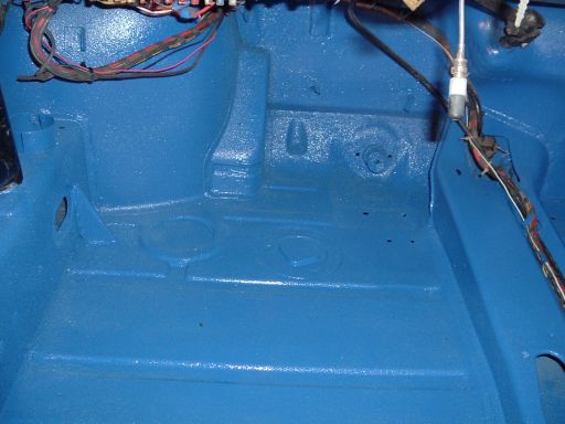

cdmcse   OK, more progress...Top coated the POR-15 with som...   Mar 4 2005, 01:22 AM
cdmcse   http://www.914world.com/bbs2/...   Mar 4 2005, 01:23 AM
cdmcse   Driver's Side.   Mar 4 2005, 01:24 AM
cdmcse   Passenger Side. Next I have to finish the passenge...   Mar 4 2005, 01:26 AM

cdmcse   Well, after the arrival of our new son (March 6th)...   Apr 4 2005, 10:52 PM
cdmcse   Now back on topic...Passenger side floor re-enforc...   Apr 4 2005, 10:54 PM
cdmcse   Driver's side floor re-enforcement, this one i...   Apr 4 2005, 10:56 PM
cdmcse   Right Rear Floor Jackpoint.   Apr 4 2005, 10:56 PM
cdmcse   Left Rear Jackpoint.   Apr 4 2005, 10:57 PM
cdmcse   Engine Shelf installed. I finally got all the part...   Apr 4 2005, 10:58 PM
cdmcse   The interior all grinded and stripped ready to POR...   Apr 4 2005, 10:59 PM
cdmcse   The Firewall had Zero Rust!!!! Yay...   Apr 4 2005, 11:01 PM

cdmcse   A little farther along... POR-15 Silver Applied   Apr 7 2005, 11:08 PM
cdmcse   Another...   Apr 7 2005, 11:10 PM

cdmcse   Well I reached what I feel like is a major milesto...   Apr 12 2005, 09:44 PM
cdmcse   Another...   Apr 12 2005, 09:45 PM
cdmcse   Another   Apr 12 2005, 09:46 PM
