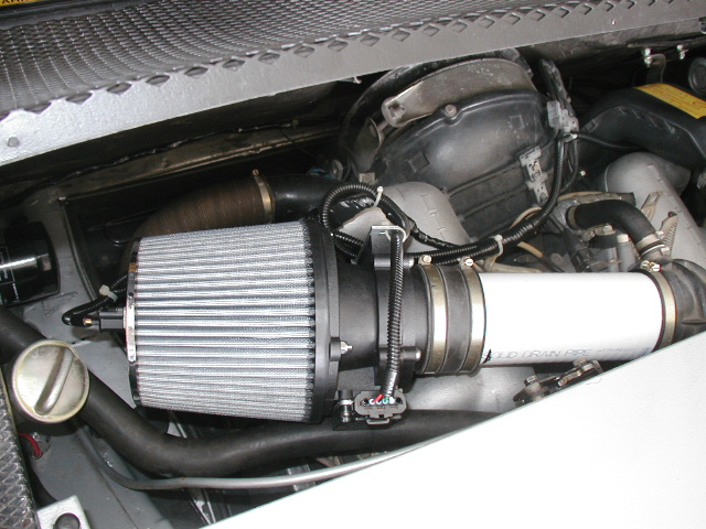

Here's a picture of my motor with a Ford MAF.
All brackets, adapters and fittings are from home depot. I'm also running the KEP stage 2 kit. The instructions said to take out the washer which I did. I can't tell if it helped or made it worse. I still had to adjust the clutch pedal for maximum throw to the floor. My throw out bearing also seems like its always touching the pressure plate. GPR and PMS said they have never had this problem. The instructions also say the throw out bearing should not touch the pressure plate. They also recommended a spring on the throw out arm to make sure it doesn't rub. I have to push the clutch all the way to the floor otherwise reverse will grind. It was worse until I replaced the terry cable weltmeister special with a factory six clutch cable. Attached image(s) ![]() |
