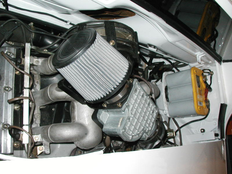

now that my 3.2 conversion is up and running I have a few bugs to work out, and i'm hoping to gain some knowledge from others that have been there done that.
My car is a 74 that previously had a 2.7 and now has a 3.2 with a KEP stage two clutch PP set up, stock DME 3.2 , and Rich Johnson mount.
My questions are:
1. How is your airfilter routed with pics please. My AFM is in it's semi orig location and my current cone filter is just barely hitting the lid. I have a smaller diameter cone on order, but wanted to see what others have done.
2. I was told, that my Pilot bearing on the tranny seems to be turning all the time. My engagement is closer to the floor than i'm used to but even with a small spacer on the clutch cable end, i'm still at the end of thread for the adjusting nuts. Is a bigger spacer the answer or am i missing something specific to the kennedy set up that I should do.

Forgot I already posted some pics on another thread, so here's my current set up, that does NOT clear the GT lid by less than 1/4 inch...
