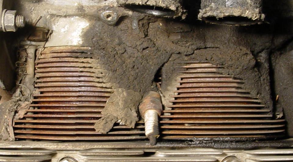

4) CLEAN everything. If your pressure sender has been leaking for very long all the oil will have attracted dirt to make a very nice substance with the viscosity of spackling compound. This oil and mud paste may be completely blocking your oil cooler, and cooling fins. (see pictures below). Now if your leak is a recent occurence this might not be the case, but when I got my car it ran hot and this was why. Just cleaning this gunk out of the fins and cooler lowered my oil temps by a full 20 degrees (thats degrees with a C, not an F!!!! (IMG:style_emoticons/default/ohmy.gif) ) At this point you can also replace your oil cooler seals and it will take all of 2 minutes and there will be no swearing, bleeding, crying or throwing of tools.
Here's what mine looked like before the cleaning.
-Ben M.
