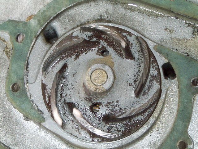

Here's the carnage. The water pump is fucked. It was boring into the block.
We have a pump on its way from CA. A huge thanks to XITSPD (Dan Callicot) for that one.
We'll have the car on the road tomorrow. (Porsche tensioning tools are for people who don't know cam belts).

rick 918-S   The pump was a reman. I installed it late last sum...   Apr 28 2005, 01:28 AM

Joe Ricard   Unfortunately this is not an easy job for a 928 mo...   Apr 28 2005, 10:29 AM
CptTripps   Yeah, but Rick could build that engine in his slee...   Apr 28 2005, 10:35 AM
tesserra   That critical tension adjustment is most likely wh...   Apr 28 2005, 10:55 AM

rick 918-S   Thanks all, Dan pulled some strings and the pump i...   Apr 28 2005, 03:10 PM

PorscheTom   Ouch! That's some picture of damage. The...   Apr 28 2005, 03:46 PM

jim912928   Yes, euro 928 engines and all 32V 928 engines are ...   Apr 28 2005, 05:35 PM
SLITS   Rich.... I just talked to our water pump expert f...   Apr 28 2005, 06:01 PM
