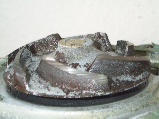

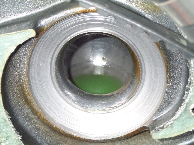

Series9   Here's the carnage. The water pump is fucked....   Apr 28 2005, 12:20 PM

PorscheTom   Ouch! That's some picture of damage. The...   Apr 28 2005, 03:46 PM

Aaron Cox   is the block going to survive???? ...   Apr 28 2005, 05:10 PM
jim912928   Yes, euro 928 engines and all 32V 928 engines are ...   Apr 28 2005, 05:35 PM
