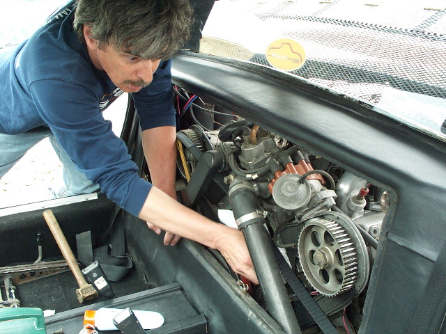

Rick just called. He's 30 miles west of Albuquerque and his water pump is failing. He has water and is going to try to get her here, but Nico and I are on stand by with the Burb and a strong rope.
I guess he'll be a house guest for a couple of days.
Any one have a 928 water pump you can overnight?

rick 918-S   The pump was a reman. I installed it late last sum...   Apr 28 2005, 01:28 AM

spare time toys   Rick, while you have the front of the engine in vi...   Apr 28 2005, 07:16 AM
xitspd   Joe, One of my friends owns 928 International in ...   Apr 28 2005, 07:22 AM

Joe Ricard   Unfortunately this is not an easy job for a 928 mo...   Apr 28 2005, 10:29 AM

tesserra   That critical tension adjustment is most likely wh...   Apr 28 2005, 10:55 AM
Series9   Here's the carnage. The water pump is fucked....   Apr 28 2005, 12:20 PM

rick 918-S   Thanks all, Dan pulled some strings and the pump i...   Apr 28 2005, 03:10 PM

jim912928   Yes, euro 928 engines and all 32V 928 engines are ...   Apr 28 2005, 05:35 PM
SLITS   Rich.... I just talked to our water pump expert f...   Apr 28 2005, 06:01 PM

rick 918-S   I'm home! Great to be here! You know w...   Apr 30 2005, 11:56 PM
