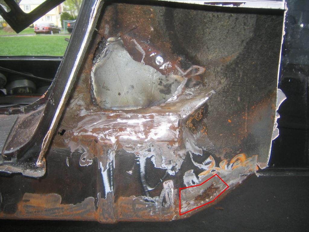

do you think i can get by with taking this much out? or should i do more?
also, is the long in this area 2-ply?? because it seems there is more metal behind that, its not hollow
what is the best way to approach cutting this?

i love porsche   do you think i can get by with taking this much ou...   Apr 28 2005, 05:01 PM

i love porsche   and for the new problem after my "discovery" of t...   May 3 2005, 05:07 PM
rick 918-S   Fix it right. You'll be happier in the long ru...   May 3 2005, 05:13 PM
