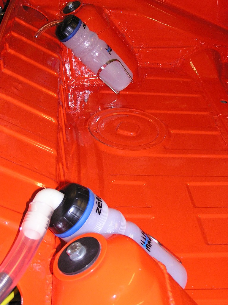

As mentioned on page one of this thread.
We went with bike bottles because of cost effectiveness and weight.
You can buy bottle frames in any material, and they tell you how many GRAMS they weigh... not ounces but rather grams.
we went with aluminum (over titanium) because they are so cheap:
