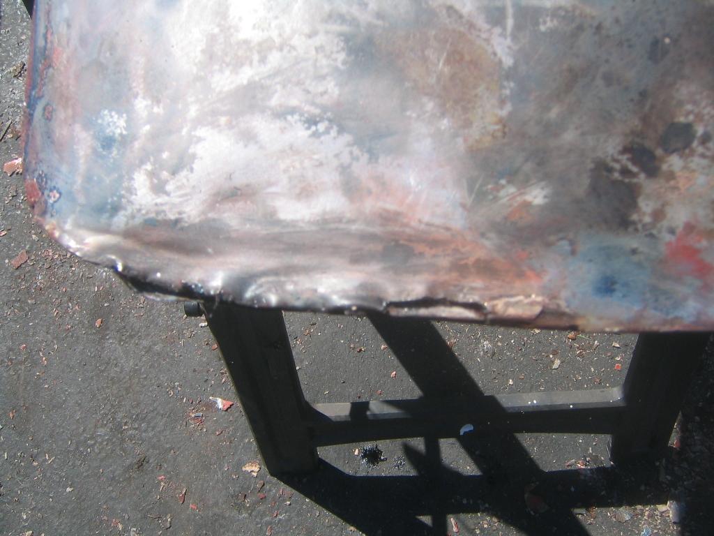

i love porsche   ok..so i began repair on a rust hole in the front ...   Aug 20 2004, 09:55 PM
i love porsche   the donor piece   Aug 20 2004, 09:55 PM
i love porsche   all fitted up   Aug 20 2004, 09:56 PM
i love porsche   all welded up :welder: not too bad for a first ...   Aug 20 2004, 09:57 PM

i love porsche   so..in a little bit of drizzle today, i cut the pa...   Apr 22 2005, 02:22 PM
i love porsche   do you think i can get by with taking this much ou...   Apr 28 2005, 05:01 PM

i love porsche   and for the new problem after my "discovery" of t...   May 3 2005, 05:07 PM
rick 918-S   Fix it right. You'll be happier in the long ru...   May 3 2005, 05:13 PM

i love porsche   ok...started stripping the front hood and fenders....   Jun 7 2005, 10:50 AM
i love porsche   rust is fun!   Jun 7 2005, 10:51 AM
i love porsche   test fit of the new piece   Jun 7 2005, 10:51 AM
i love porsche   all welded up   Jun 7 2005, 10:52 AM
i love porsche   it follows the curve pretty nicely IMO   Jun 7 2005, 10:53 AM
