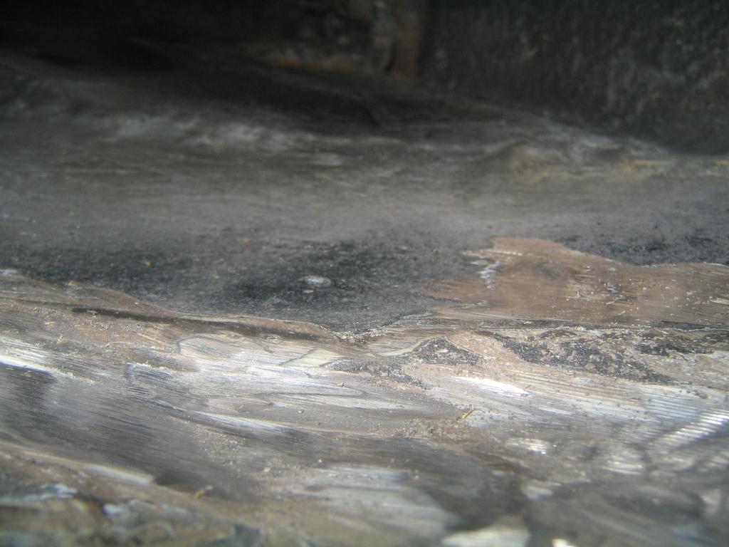

and for the new problem
after my "discovery" of that nice little rust spot on the driver long, i decided to take a look at the passenger long again and see if i noticed anything more
well...now that ive been looking at longs so much, i realize that this thing doesnt really look like a longitudinal at all!
its flat, straight up, and looks like filler, so i go and get a magnet to test for metal....
magnet falls right to the ground
now im thinking...oh crap..what did the PO do to this car....so i get the grinder and do some grinding, and i see metal...its all metal..just with filler over it.
so i test the magnet again...nothing
oh crap, its a big ol sheet of aluminum...
so what do i do, im not sure if its tig welded on or just bonded..id assume the latter, because of the incompetence of not using the right piece
how big of a hole am i in...should i go sawzall happy and cut it all out and redo? or is it possible to trust the aluminum in this spot

i love porsche   and for the new problem after my "discovery" of t...   May 3 2005, 05:07 PM
rick 918-S   Fix it right. You'll be happier in the long ru...   May 3 2005, 05:13 PM
i love porsche   ok, i finished up the driver long...all nice and t...   May 4 2005, 03:45 PM
i love porsche   well..it turns out what i thought was aluminum, wa...   May 5 2005, 01:28 PM
