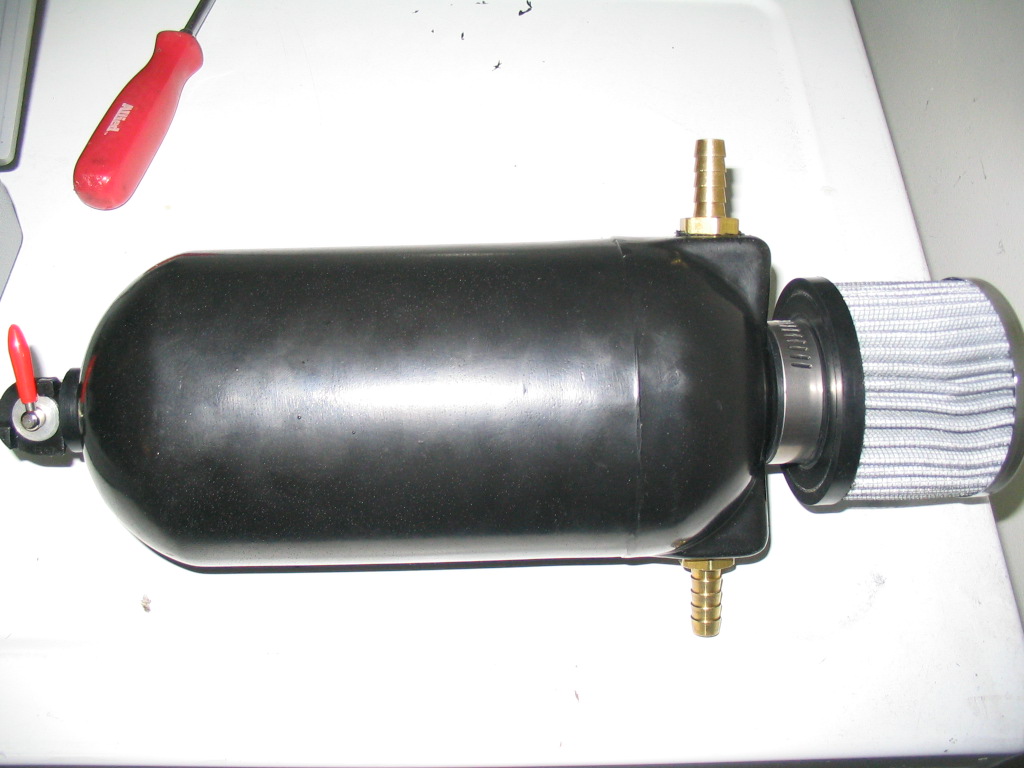

FYI
Here is the summit bottle with new connectors (it comes with only one) and it's threaded, I thought these would work better.

Oracle   FYI Here is the summit bottle with new connectors...   May 3 2005, 08:01 PM
Oracle   Here it is bolted down...   May 3 2005, 08:02 PM
