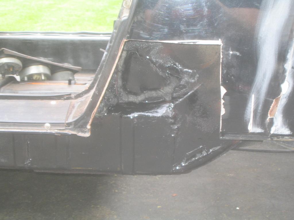

i love porsche   ok..and my repair...remember, no laughing!   Mar 17 2005, 04:30 PM
i love porsche   after i cut out the bad   Mar 17 2005, 04:31 PM
i love porsche   and all fixed up, this is a pic before i primed it   Mar 17 2005, 04:31 PM
root   Great work! Your catching up with me and I sta...   Mar 17 2005, 04:48 PM
