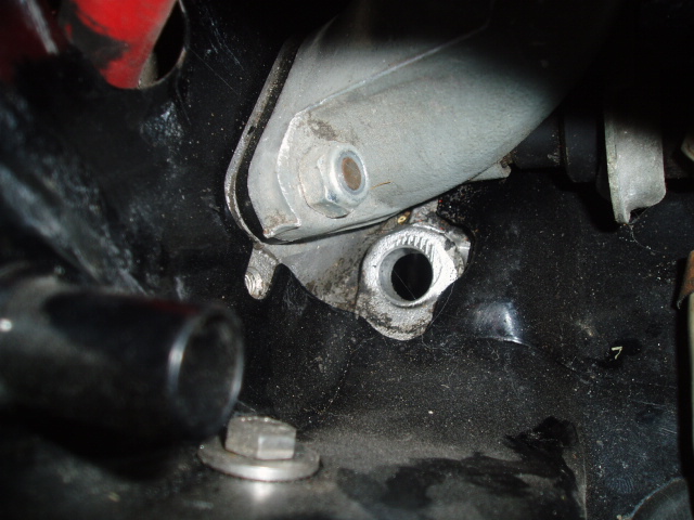

what does this do? do i need to plug it?

nebreitling   third pic is the vent to the head. you should plu...   May 6 2005, 08:08 PM
