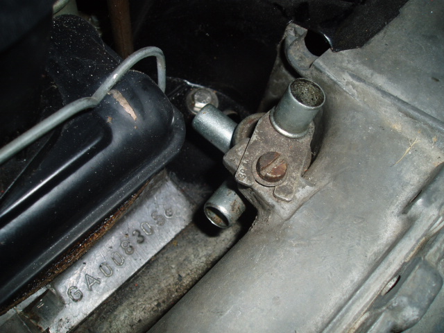

and these??? (IMG:http://www.914world.com/bbs2/html/emoticons/confused24.gif)

nebreitling   third pic is the vent to the head. you should plu...   May 6 2005, 08:08 PM
