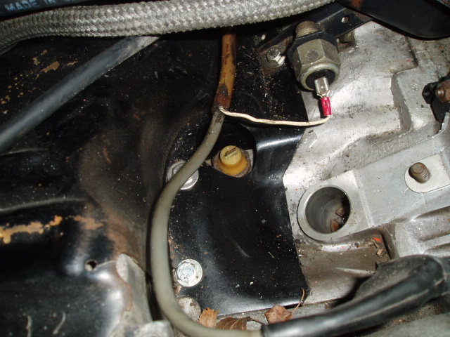

wilchek   maybe this will help with lines   May 7 2005, 01:44 PM
wilchek   and closer   May 7 2005, 01:46 PM
wilchek   and sensor looks like green/red wire goes to it.   May 7 2005, 01:55 PM
wilchek   it looks like it comes out of wiring harness here   May 7 2005, 01:58 PM
