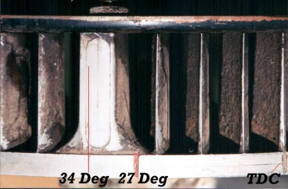

heres my distributor. So i take the points and condensor off....how do i find tdc w/ the engine on the stand w/ no flywheel?? Any pics of how to mount the optics, i have an idea but not which direction.

thats right, the cooling fan has a mark that is viewed through the little hole in the cooling fan housing. There is an article on the "tech articles"
914 timing with carbs on pp
Remove the round black plastic cap and look ind
It has this picture-

Travis Neff   To find TDC on number 1, rotate the engine and loo...   May 6 2005, 08:08 PM
SGB   thats right, the cooling fan has a mark that is vi...   May 6 2005, 08:29 PM
Travis Neff   Picture is worth a thousand words - just remember ...   May 6 2005, 08:34 PM
