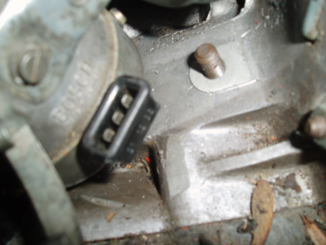

see, im a 944 guy, could build one in my sleep, this thing is all flattend out and squished!! Problem is my haynes manual sucks. The guy who built the motor i think mistakenly ran some pvc line instead of fuel line and its all hard, so i know ill be putting in some real fuel line. I have a bunch of little holes and plugs and such that i have no idea where things go, and the instructions for my crane cam optic ignition is so vague, im not even sure it has instructions for my distributor. Here is every pic i can think of...I need some advice. (IMG:http://www.914world.com/bbs2/html/emoticons/headbang.gif)
heres my distributor. So i take the points and condensor off....how do i find tdc w/ the engine on the stand w/ no flywheel?? Any pics of how to mount the optics, i have an idea but not which direction.

ok, figured out the fuel lines, i think the guy had some vac line run instead of fuel line, a year old and they are hard as a rock? I think i figured out the distributor, got the engine off the stand and set to tdc, then set distributor in and figured out where to mount the sensor for the crane cam unit. FINALLY got it all to clear each other w/o interfering w/ the vac advance and itself. Now i have a question..or two.

wilchek   maybe this will help with lines   May 7 2005, 01:44 PM
wilchek   and closer   May 7 2005, 01:46 PM
wilchek   and sensor looks like green/red wire goes to it.   May 7 2005, 01:55 PM
wilchek   it looks like it comes out of wiring harness here   May 7 2005, 01:58 PM
