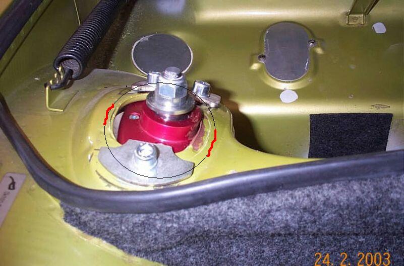

although not as slick as bending here is my way
if you cut an oval shape out of the tower with the center shifted to the center of the car, then took the section cut out and swaped it side for side on the car and welded it back it the holes whould be un modified. the oval on the pic is a poor example of where you would have to cut but it should give you an idea. the red lines show how much you would gain by swaping side to side. if you cut it 1/2 inch torwards the center you would gain 1/2 inch of adjustment.
i hope you can see what i mean with the pic
