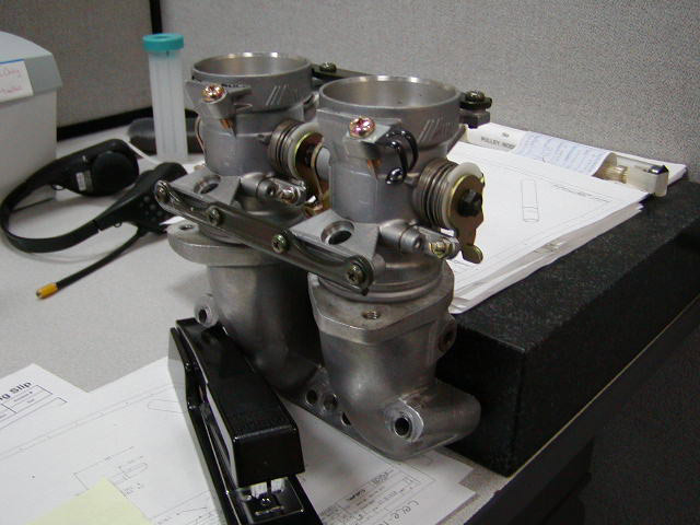

The cost of aftermarket throttle bodies is way up there, the bottom of scale we have the CB Performance units which are about $250 each and the rest are easily 2X that about.....
so I swung by the motorcycle salvage yard in Fremont today and picked up these beauties (IMG:http://www.914world.com/bbs2/html/emoticons/smile.gif)
45mm at the butterfly....they taper down to 42.5mm at the bottom...
includes a nice TPS and injectors...I doubt the injectors flow enough, but who knows, I'll find out once I get the specs....
no idea of what bike they came off of yet.....price was $125
top view:

played with the TB's a little over the weekend...mostly taking them apart somewhat and getting dimensions off of them for different ideas on how to mount them....

DNHunt   Mike Are those grooves in the TBs for O-rings. M...   Jan 21 2005, 02:42 PM
Root_Werks   Using bike TB's like this is a great idea real...   Jan 21 2005, 02:54 PM

Jake Raby   I have done this twice! It works... That size...   Jan 21 2005, 04:05 PM

Mueller   Just got back from the local cycle shop...found ou...   Jan 28 2005, 05:03 PM

Mueller   adapter ideas: http://www.91...   May 24 2005, 03:39 PM
Mueller   adapter 2.... this one would have a counterbore f...   May 24 2005, 03:42 PM
Randal   Nice designs Mike. Those look much shorter th...   May 24 2005, 03:56 PM
Cloudbuster   Adapter one! Go with what the factory did. H...   May 24 2005, 03:58 PM
