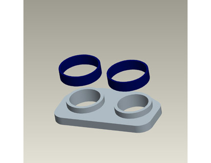

Mueller   played with the TB's a little over the weekend...   May 24 2005, 03:36 PM
Mueller   adapter ideas: http://www.91...   May 24 2005, 03:39 PM
Mueller   adapter 2.... this one would have a counterbore f...   May 24 2005, 03:42 PM
Randal   Nice designs Mike. Those look much shorter th...   May 24 2005, 03:56 PM
Cloudbuster   Adapter one! Go with what the factory did. H...   May 24 2005, 03:58 PM
