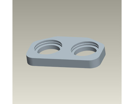

adapter 2....
this one would have a counterbore for the TB to sit inside, an O-ring groove would help for sealing...after assembled, a 2 part epoxy would be inserted inbetween the TB and the plate..the O-ring would prevent the epoxy from leaking past the bottom of the TB.
once again, the TB would also be bolted to the adapter via the bracket attaching to the protrusion on the TB...

Randal   Nice designs Mike. Those look much shorter th...   May 24 2005, 03:56 PM
Cloudbuster   Adapter one! Go with what the factory did. H...   May 24 2005, 03:58 PM
Aaron Cox   rubber: well they use rubber boots on turbo setup...   May 24 2005, 03:59 PM

Q...   May 24 2005, 04:02 PM
Mueller
MecGen   Hey Mike The size of the injector hole/mounts, is ...   May 24 2005, 04:05 PM

Randal   Mike - Can you make adapter 2 out of the same met...   May 25 2005, 02:58 PM
andys   ...   May 25 2005, 03:27 PM
Mueller   <...   May 26 2005, 12:02 AM
McMark   Mike, I'm probably going to be buying a TIG se...   May 26 2005, 01:01 AM
Mueller   <...   May 26 2005, 10:13 AM
