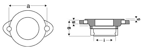

The cost of aftermarket throttle bodies is way up there, the bottom of scale we have the CB Performance units which are about $250 each and the rest are easily 2X that about.....
so I swung by the motorcycle salvage yard in Fremont today and picked up these beauties (IMG:http://www.914world.com/bbs2/html/emoticons/smile.gif)
45mm at the butterfly....they taper down to 42.5mm at the bottom...
includes a nice TPS and injectors...I doubt the injectors flow enough, but who knows, I'll find out once I get the specs....
no idea of what bike they came off of yet.....price was $125

QUOTE(andys @ May 24 2005, 03:58 PM)
Mike,
You might consider the stock bike manifold rubber bonded aluminum adapters. I'm willing to bet they are a two-bolt pattern type with the correct coupling for the throttle bodies. Transfer the bolt pattern to your manifolds, and you're good-to-go. You may be able to find these aftermarket as well.
Andy
I've looked at the intake flange you speak of.......I cannot find them used (normally sold with the motor)...and brand new they are $35.99 each.....(I'd need 4 of those puppies...ouch)
(IMG:http://www.914world.com/bbs2/uploads/post-2-1111719656.jpg)
Dan,
I would be nice to have it so that minimal machining needs to be done, this way it would open the door for more conversions.....I'm sure it'll work, just how much effort it'll be is another story (IMG:style_emoticons/default/smile.gif)

Mueller   played with the TB's a little over the weekend...   May 24 2005, 03:36 PM
Mueller   adapter ideas: http://www.91...   May 24 2005, 03:39 PM
Mueller   adapter 2.... this one would have a counterbore f...   May 24 2005, 03:42 PM
Randal   Nice designs Mike. Those look much shorter th...   May 24 2005, 03:56 PM
Cloudbuster   Adapter one! Go with what the factory did. H...   May 24 2005, 03:58 PM
