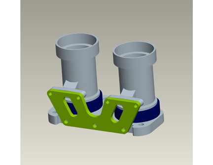

Andy,
I think a brace similar to the green one here should work to hold the TB's in place along with the hose/clamp parts.
