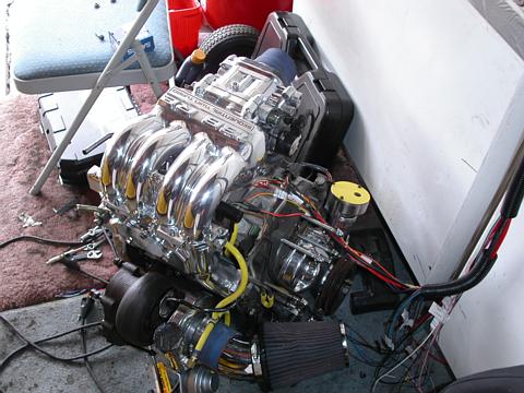

Hi All,
I've been lurking around for a while now and felt it's time to get off my A$$ and put a teener back into my life. I went and rolled my last project car out of my ma's garage, a 1974 2.0 914. It has some rust issues in the rear trunk and the PO had some crappy repairs done to it, but I'm not complaining. This car has been sitting for over 10 years in my ma's garage. This would be my second rotary 914. The first rotary 914 I ever had was over 10 years ago, and it survived stop and go traffic and a vacation to SF california, I live in LA. It was my daily driver to my first "real" job for 3 years. But 3 years of daily driving really took it's toll on my poor 914 and lack of parking forced me to send it to the autobahn in the sky. I kept all the parts and I'm starting the project again.

Rotary'14   Time to meet Rotary NARP   May 22 2005, 05:07 PM
Rotary'14   That's the engine attached to the transmission...   May 22 2005, 05:09 PM
Rotary'14   another   May 22 2005, 05:09 PM
Rotary'14   another with a pic attached,,   May 22 2005, 05:10 PM
Rotary'14   a mock up of my cooling set up, similiar to the on...   May 22 2005, 05:12 PM
