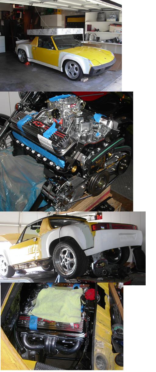

QUOTE (porsche913b_sp @ May 27 2005, 11:42 AM)
Hi lybones (Tom)
I too was impressed by your yellow 914. Could you please post some closer pic of the front end of your yellow 914, particularly the opening for the radiator. I like how you did not have to cut into your chrome bumper, very clean look. Also if you be so kind, some photos of your raditor in your front trunk.
Thanks in Advance
Ted
Fellow rotary 914 bro
Ted,
My car is currently under the knife again. so I will have to take new pics. I actually swapped out that front chrome bumber with a fiberglass one. I originally cut a large horizontal slit on the front valance to avoid the hole on the chrome bumper. But it just was not adequate enough to cool the car. I know they make nice front spoilers that has a scooped opening now. My v8 swap is almost complete. Here's a more current pic of the car.
